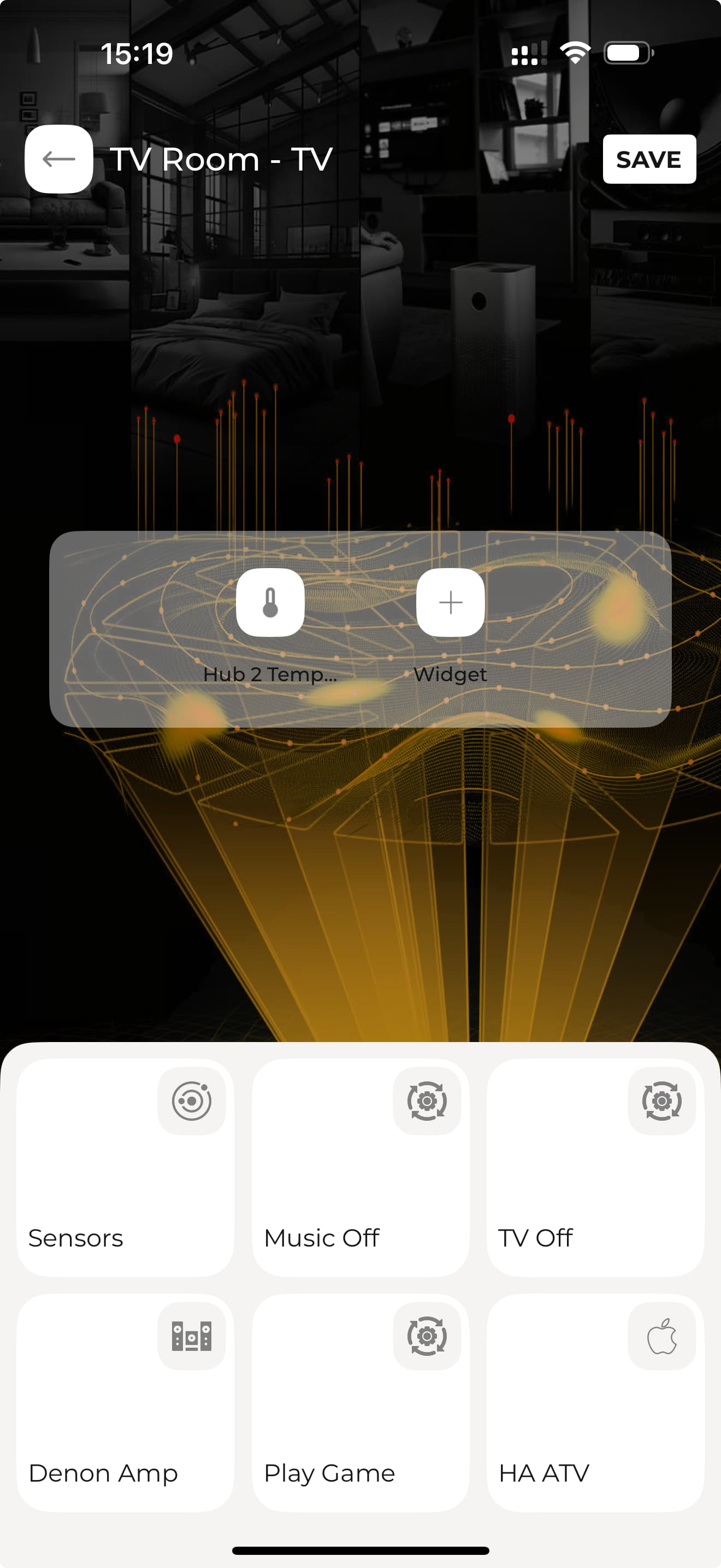

This is what I save-:
If I then go to ‘Sequence’ and then back to Rooms the same room shows this-:
