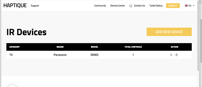

We are working on something like this have a look:
Ty. Very important for my set up to have this.
Any update on this?
It is live now but we are working on some rules to limit users pushing any random unverified IR data on the db. By this week it should be public.
