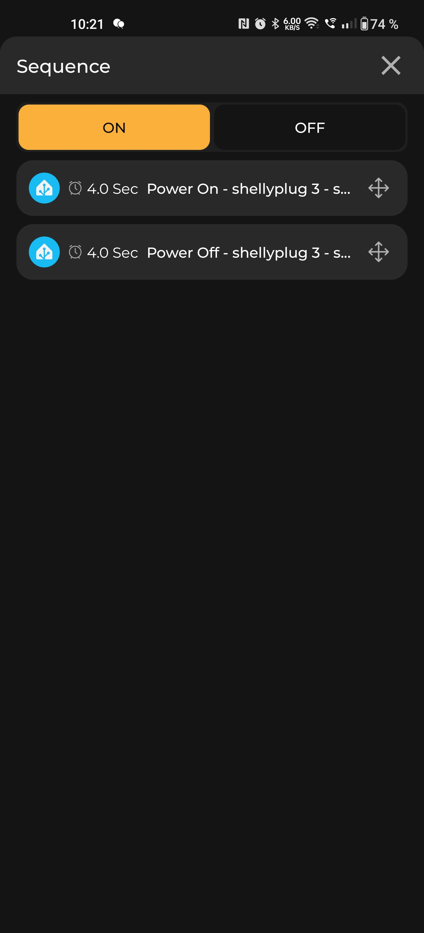

What I found out so far:
  1. I can switch an entity, if I press long on the switch in a room and then use the power button or the button on the display
  2. I cannot switch the entity within a sequence. I created a simple sequence to test this. If I long press on the sequence/macro it shows the single steps on the screen but the entity is not switched:
  3. I can not switch the entity using quick buttons
  4. I can not switch the entity using hardware buttons that I assigned in the sequence.
  5. When I change a sequence or ad a device, the room gets automatically populated with the new device or sequence, The prvious setting is gone and needs to be restored manually.
We have found out that with the new update something broke, we are fixing the home assistant entity handling and planning an update for tomorrow. We will try our best to get this update this week.
just installed the update. HA integration is working like expected now. Thanks.
