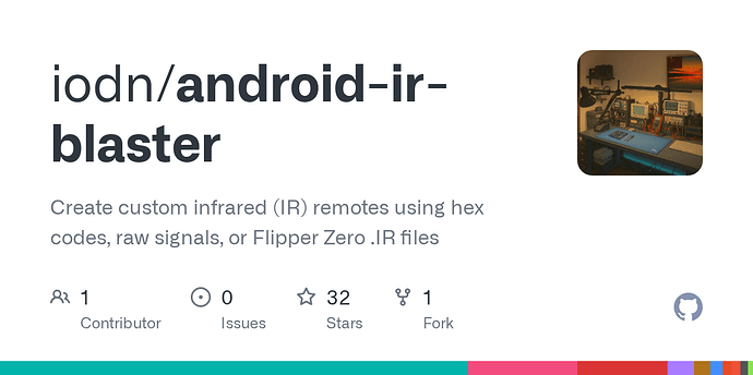

I want to run something like :
This app is great, and the UI even fits well on the RS90.
The main draw, for me, is it will take the saved files from custom remotes made with a FlipperZero and send the captured RAW data out, with custom images and a nice interface.
However, the IR does not work on the RS90, when it does with a normal Android phone/device with IR built-in. :downcast_face_with_sweat:
@ccsfounder, does the RS90 use something custom, that’s not a “built-in IR”? I guess we could stick a USB-C IR blaster in the bottom of the remote and use it upside down… but I’d rather not!

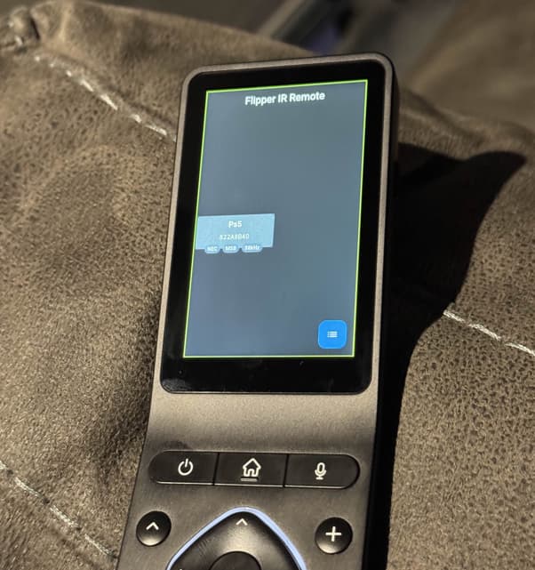

To confirm, this is a loaded save from FlipperZero.
Using FlipperZero, it plays back and switches my Denon amp to my PS5.
However, it doesn’t work on the RS90. Does it work for you, @ccsfounder ?
Maybe I just have a defective unit in that case, which would explain why i’m having issues with the official apps?
