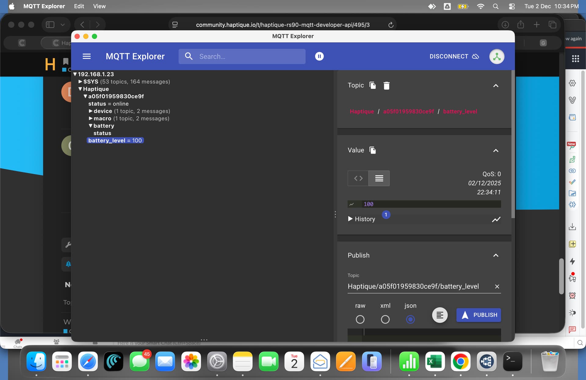

Hi,
I’m currently working on HA integration, but on my side i don’t have battery level in MQTT haptique Topic. Is there a particular settings on Haptique remote to publish the battery level value ?
Thx
Publish this topic and you should get the response
Haptique/{RemoteID}/battery/status
@ccsfounder ,
It’s working.
Thx a lot :wink:
