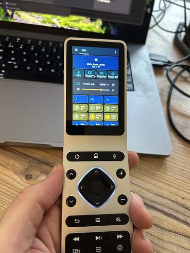

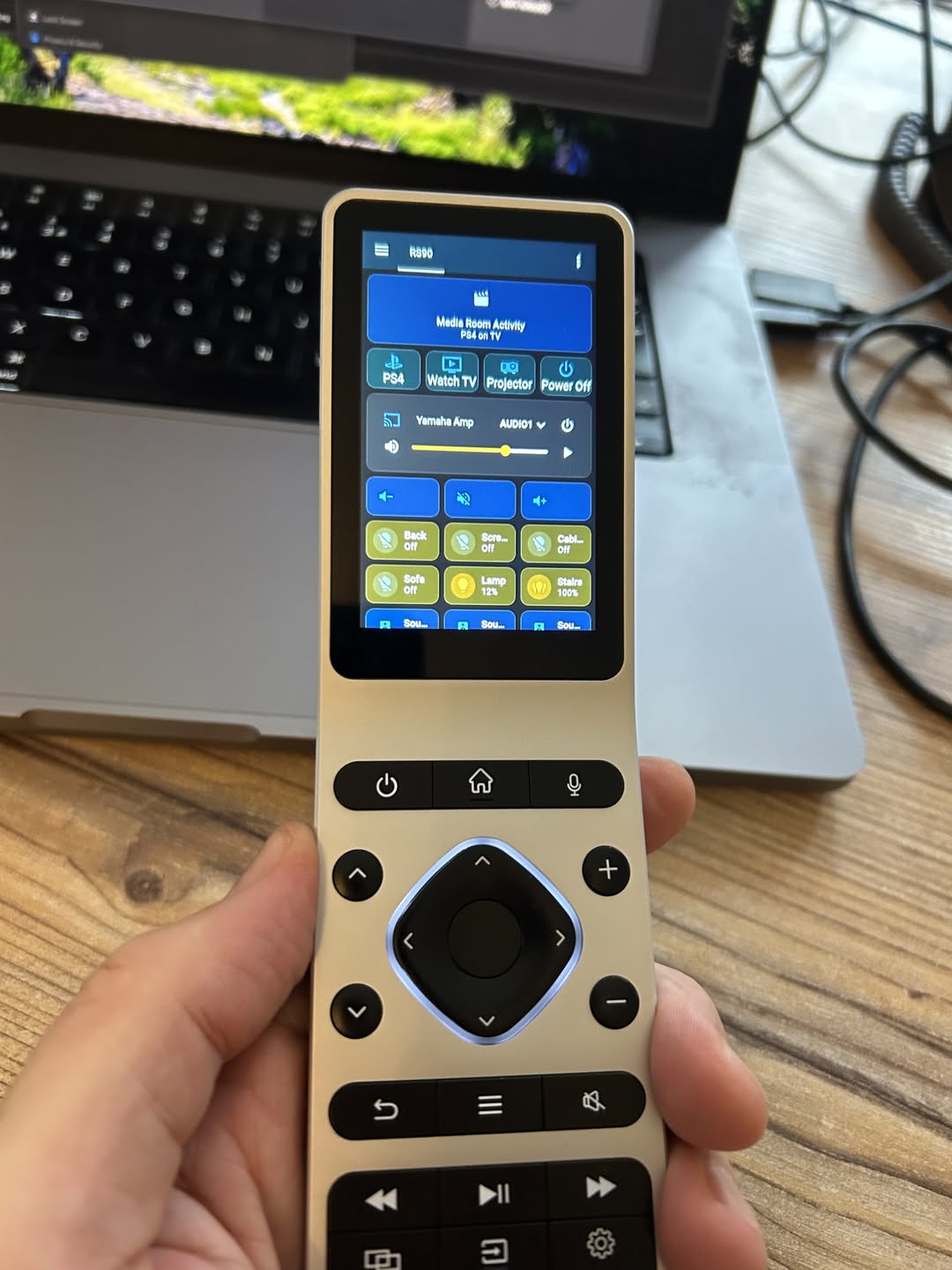

Hi all, I am a Home Assistant user and have bought a Haptique RS90 hoping to be able to combine Home control with AV control using one. To be honest I would be quite happy to do everything through Home Asssistant and bypass the RS90 firmware completely.
I have created a Home Assistant dashboard and managed to install Fully Kiosk Browser which I hoped would allow me control over the buttons but I can’t get the buttons working.

A little late reply but I read somewhere that button mapper works, maybe you could use that to enable the buttons? I like what you have done there though.
the looks great. this is via kiosk browser from the store on the remote?

It’s on the fully kiosk browser installed using the Aurora store. I have not tried hard or had much luck controlling anything yet. I’m not a big fan of the UI and will be more than happy when they add mqtt, I’ll the be able to use my own UI.
