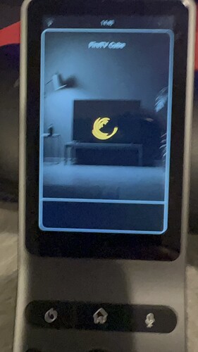

I added the FireTV Cube with the app to my Room. But when I try to use it, the spinning icon comes up and none of the buttons control anything. How do actually add a FireTV and control it successfully? Its my main device and I cannot control it at all so far.

Yes I can detect the device and set it up as FireTV OS. But when I try to press the icon to control it, it just spins in the middle screen for a while then nothing shows on the main screen and none of the buttons control anything.
Is the device then mapped to a room icon?
Can you show via screenshot?

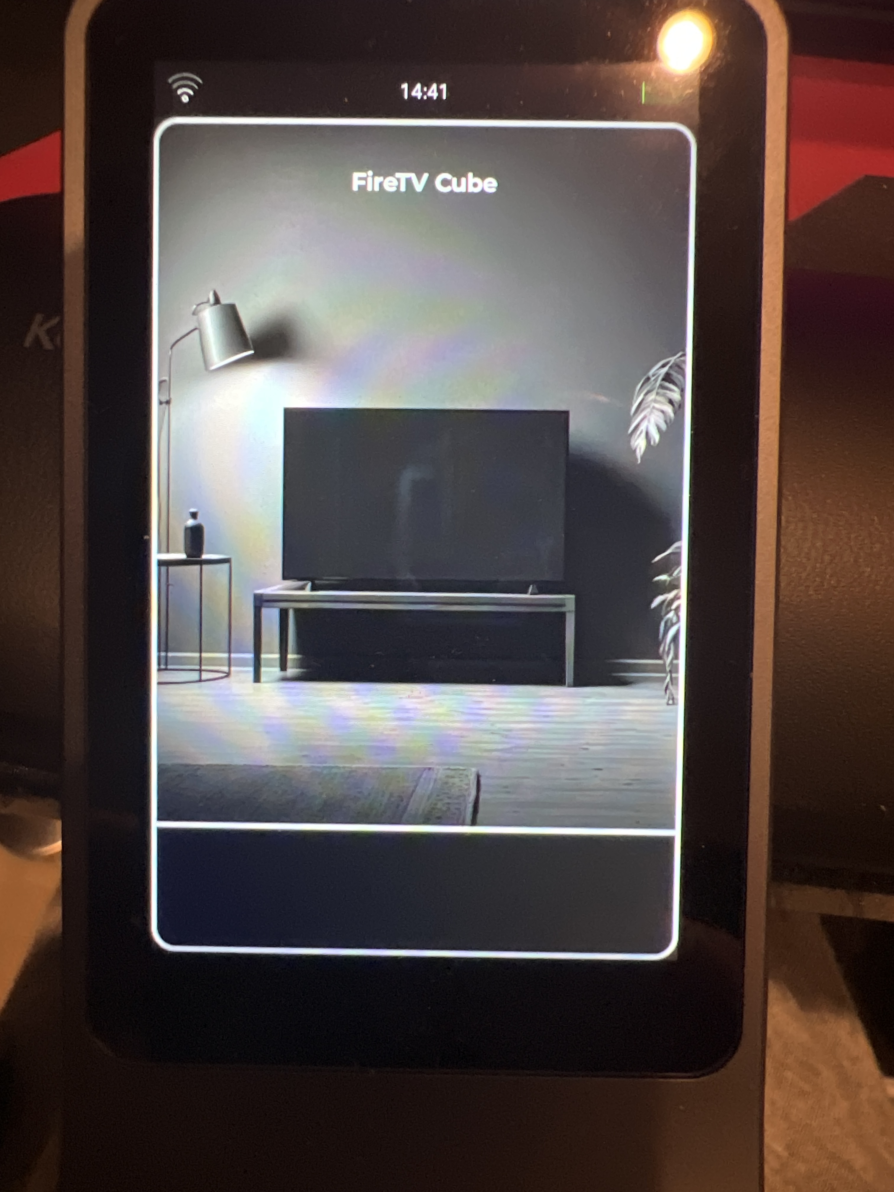

This is what I see. Then to blank screen:
Blank screen means Haptique is not getting the list of installed app but is connected.
Test the navigation button are they working?
We have a Fire TV stick 4k which is working with current Haptique version. But few others like TVs built in Fire TV(TCL) is not. So must the same case for you and many others.
Our team is evaluating this and working on an update to fix this issue.
