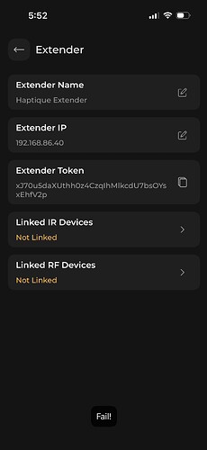

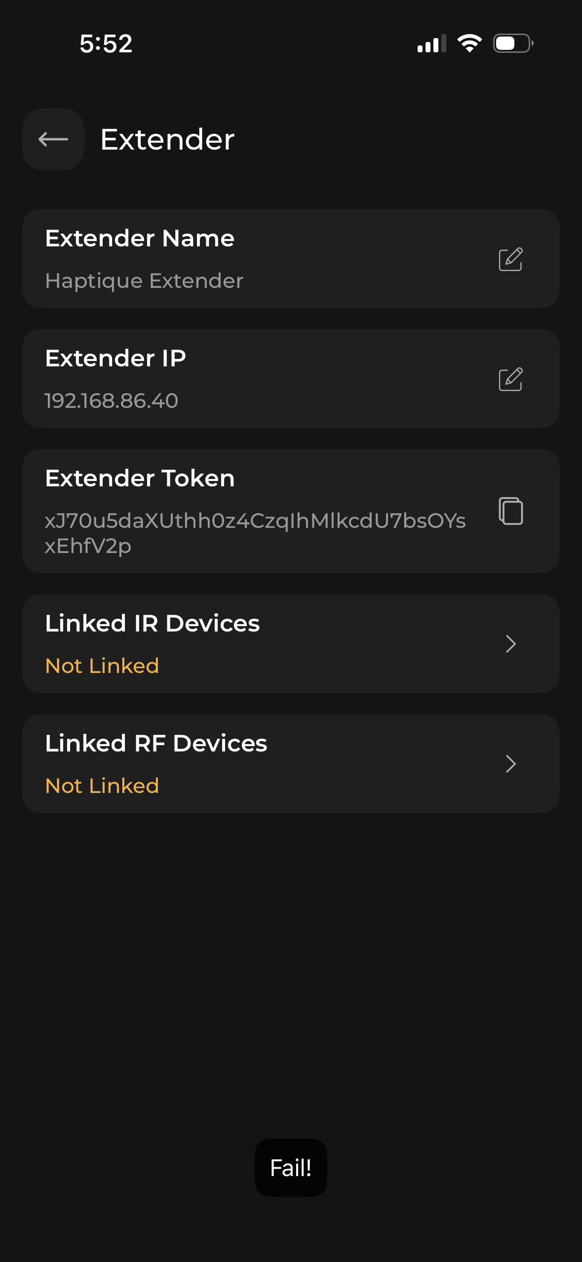

I just got my IR+RF Hub and when I try to link my IR devices, I get a Fail! Indication. This happens for all devices I try to link. Any idea how to fix this?

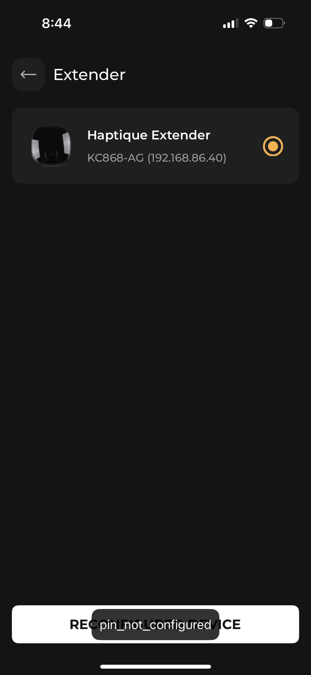

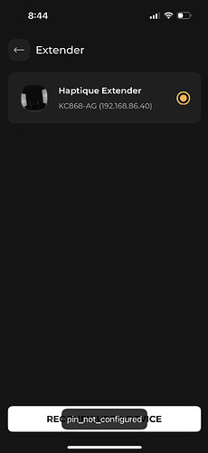

So it looks like the configuring is a one-time event. When I click “Already Configured? Add Device”, and select the Extender and press “Reconfigured Device”, I get an error “pin_not_configured”.

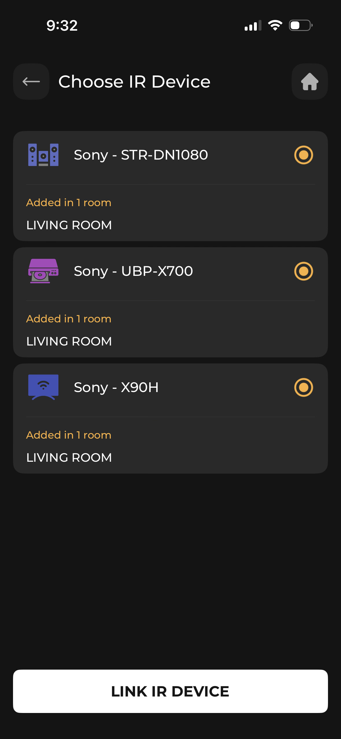

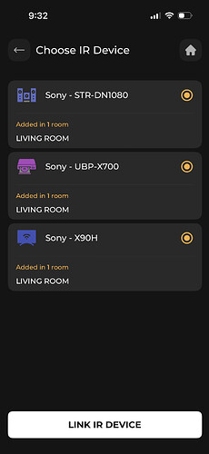

Have you link your IR device via to Hub. If yes please share a screen shot. If not, visit Extender settings and link the IR device you want to send via Hub/Extender and sync the Haptique.
Yes, I’ve linked 3 devices. What happens is when I add an IR device and use the hub to read the OEM remote signals, it registers the signal but when I test the signal through the Haptique app, the device doesn’t respond. I then sync the devices to my RS90 and they don’t respond to that either.
