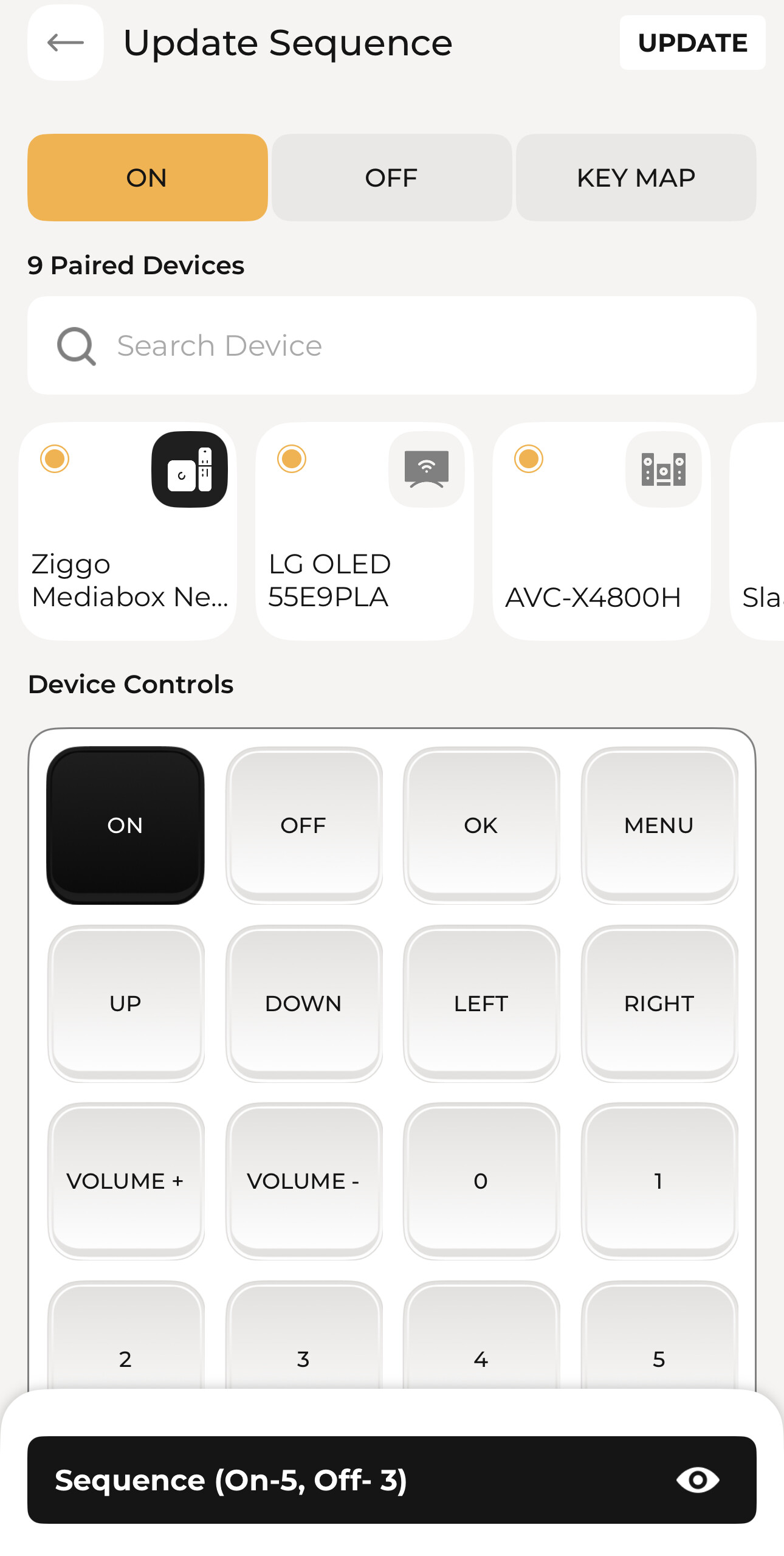

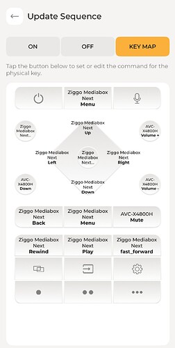

@Stef, did you check button assignments in the macro? There you can choose commands for the on and off sequence per device, so that is also where you could potentially reverse them by accident.
It works fine when controlling the individual devices. But when the devices are operated via the macro, the ON and OFF buttons seem to send reversed signals.
In response to xahmol’s comment: no, the button commands were not accidentally swapped in the macro key assignments.
