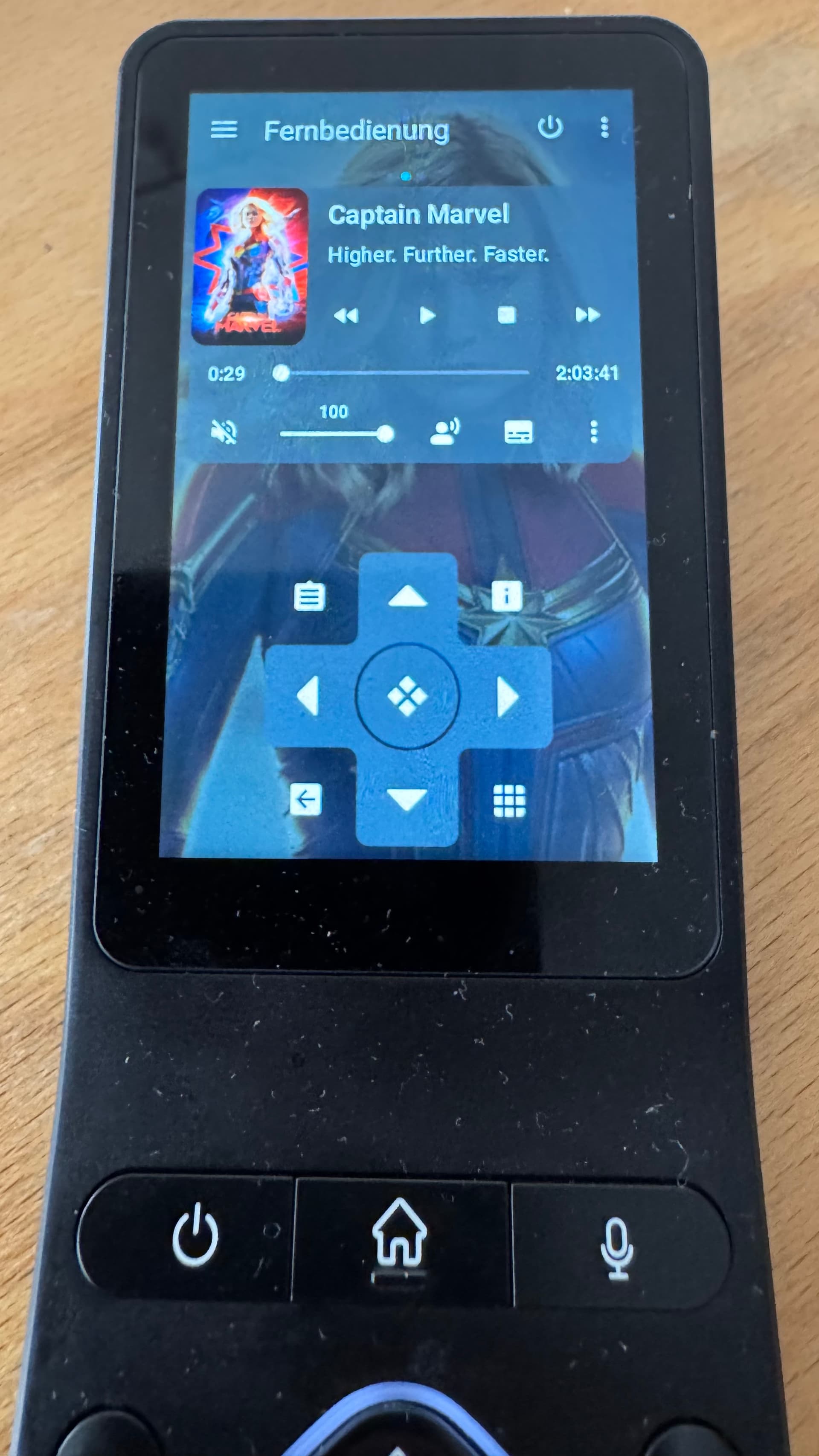

Does the Kodi app on the RS90 work for you? I can also control Kodi from my RS90 via the Kodi app and HTTP requests via Custom IP Device. But that’s just for testing. I personally use Plex, not Kodi, for everyday use.
Kodi App on the RS90 for controlling Kodi
Can you set the remote buttons while using the kore app
No, unfortunately, the manufacturer doesn’t currently support natively having an app in focus on the display while still being able to use custom IP commands directly with the RS90’s buttons. I’ve already reported this as a point of criticism and a fundamental feature request to the manufacturer.
I personally use Symcon as a system alongside the RS90. Symcon can process the RS90’s button presses via MQTT, even when an app is in focus on the RS90. This allows me, at least in my setup, to have an app in focus while simultaneously using the RS90’s buttons.
Otherwise, you’ll probably have to wait until the manufacturer, Cantata, finally implements the Kodi support they announced back in 2024. Then, you should theoretically be able to use the display and the RS90’s buttons at the same time.
I’m using the RS90’s buttons as well. Currently, using an app and the RS90’s buttons simultaneously is only possible with workarounds or additional systems, such as an external system that handles the control and uses MQTT to read the RS90’s button presses, or by tinkering directly on the RS90 itself using Tasker, which analyzes the button presses and then sends an HTTP request.
