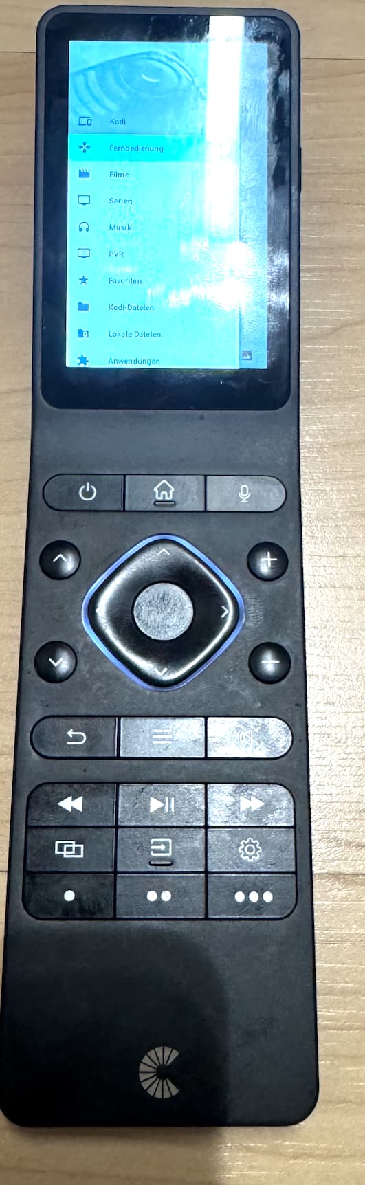

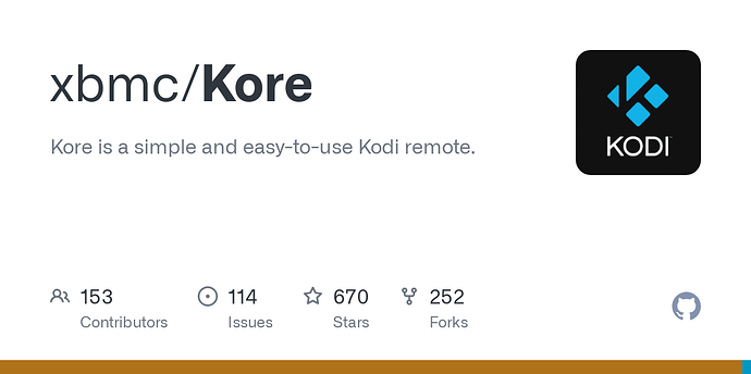

If you’re feeling experimental, you could simply replace the launcher on the RS90. Then install
Kore from the Play Store.
This way, you can continue using the RS90 buttons via Custom Commands, but at the same time have full visual access to Kodi on the RS90 display.
Kore on the RS90 display then looks like this, for example:

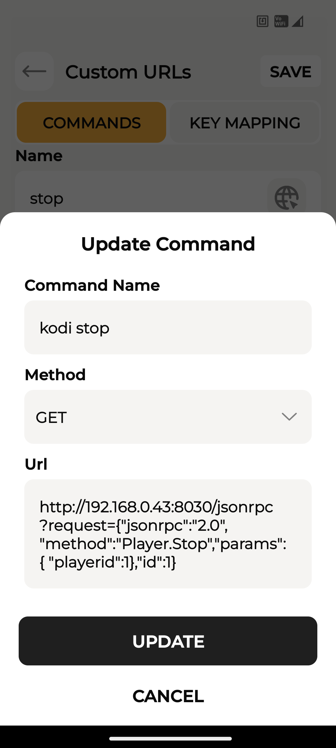

Trying to make a stop button for Kodi with custom URL and having no luck
Can anyone see what I’m doing wrong
(http://192.168.100.13:8080/jsonrpc?request)={“jsonrpc”:“2.0”, “method”:“Player.Stop”,“params”:{ “playerid”:1},“id”:1}
That’s also wrong, the url must be passed url encoded, otherwise it won’t work with GET and the RS90
try for Stop
http://192.168.100.13:8080/jsonrpc?request=%7B%22jsonrpc%22%3A%222.0%22%2C%22method%22%3A%22Player.Stop%22%2C%22params%22%3A%7B%22playerid%22%3A1%7D%2C%22id%22%3A1%7D
try for Play/Pause
If you don’t have a system that encodes the URL you can do it yourself using tools like URL encode and decode
Both of those didn’t work
While doing a quick test on the custom URL page all I got was a blank black box on the bottom of the page
Now the problem seems to be that Kodi can’t evaluate the username and password via GET, or rather, the RS90 currently offers no way to pass the username and password in a way that Kodi can do anything with.
Controlling via POST doesn’t pose any problems for me with Kodi. The problem is that the RS90 doesn’t currently support POST with parameters in custom URL commands, so you probably can’t use it at the moment.

That is the reason why I use Kore with the RS90 for controlling a Kodi System, that seems the only way at the moment to control Kodi completely and to get also status feedback in the display of the RS90.
