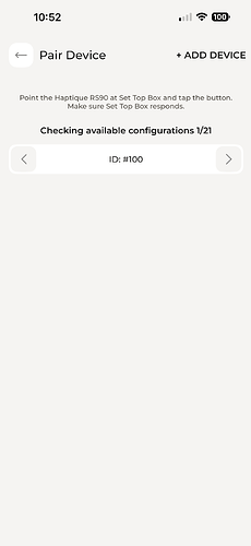

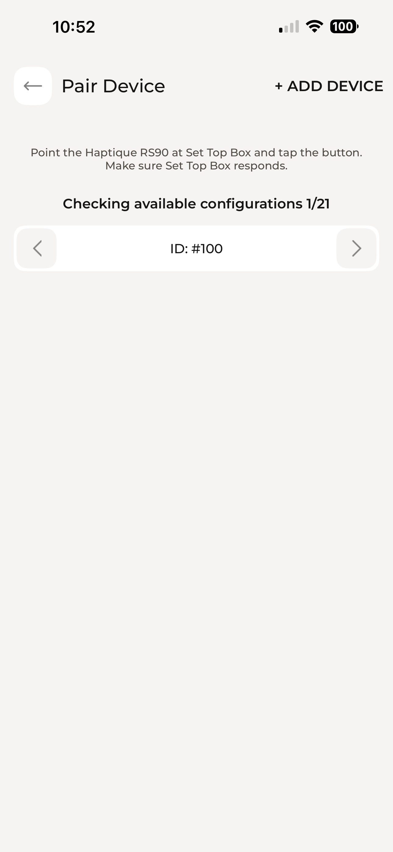

Hi, I’m no longer able to control the SkyQ box. Most of the control profiles seem to disappear. When you try to re-bind to an IR control, most of the available profiles don’t have any commands associated with them. The one that people have previously stated works with the SkyQ box (12454 and 12545) have disappeared completely from the database. See attached image. Most of the options appear like this.
So we have removed the previous data supplier completely. Now you will only find codes which were previously downloaded by others or you. For new codes now we will manually add and also allow users to add it (option coming next week).

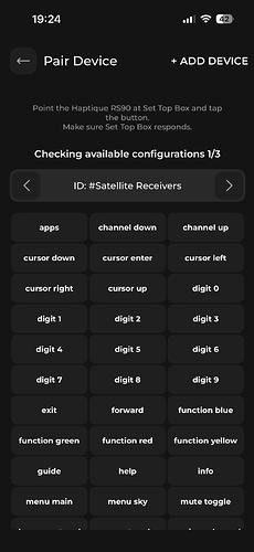

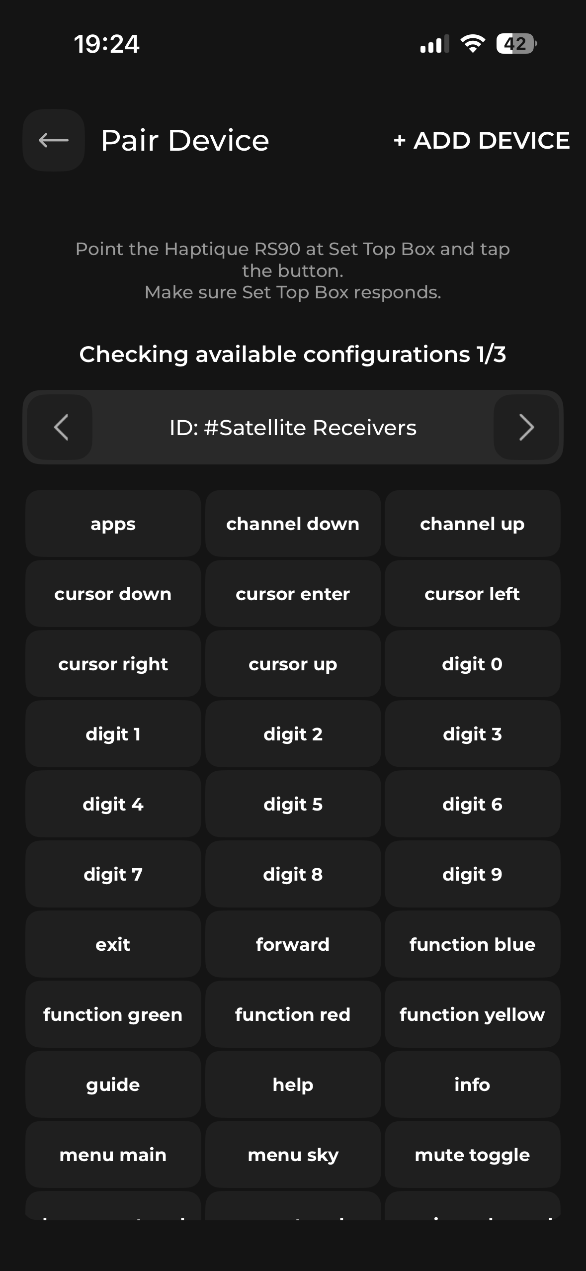

We just added a new IR file for Sky Q. Name of file is Satellite receivers. Please test and suggest.
