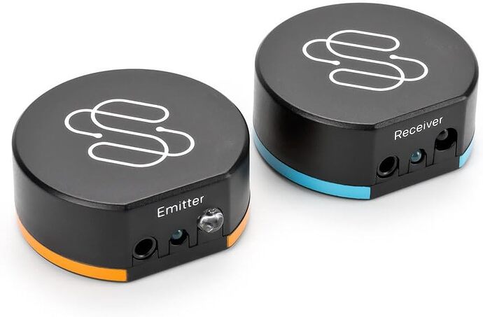

This kind of IR extender can be used to extend the range of RS90.
